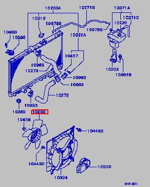

    guys, one of my customers has ordered 2 radiator fans from me, and we keep sending the "wrong" one to her.
    this is a 2001 ...
    Can one of you guys assuredly confirm for me a: which fan is on the passenger side? a/c or radiator?
    and b: the mitsu part number for that fan?
    This is causing me the BIGGEST headache I've had in a month.

    my 99 only has 1 fan but on those that have 2 fans, the passenger side fan is the A/C fan

    V6 or 4cyl?
    [Edit]
    Cooling fans
    4cyl: MR312234
    v6: MR312178
    [Edit]
    CAPs does show an A/C fan too, not sure which years have A/C fans. But the numbers above are for the cooling fans. Here are the cooling fan numbers:
    A/C fans
    4cyl: Is not listing an A/C fan
    v6: MR233814
    7g for life!
