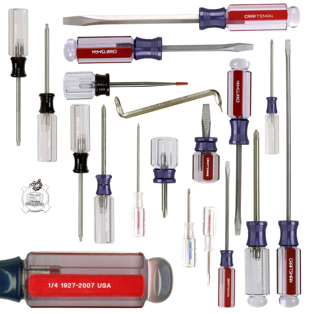

    The long skinny screwdriver from Sears 19 pcs set
    I used this exact screwdriver! Proved particularly useful, fits perfectly into the compression ring. Also used for other things. Invaluable tool.
