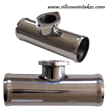

    The UICP has the BOV mounted on it, what it means is that at one point you'll have to decide what BOV you want to run. The budget solutions are 1g BOV or Greddy BOVs, I mean there are many BOVs out there that you may like. It all comes to how you want to do it. There are pre-made about 1ft long pipes with BOV flanges welded to it or its a whole thing made out of cast aluminum.
    Welded
    Cast
    If you want to use 1g BOV then it's best that you get 1g BOV elbow, cut the flange off and have a shop weld it for you. Dont take chances with 80-90 AMP flux welder and try to save $10-15 bucks. Same applies if you want custom UICP with the BOV maybe angled and other crazy things - have a shop weld it for you.
