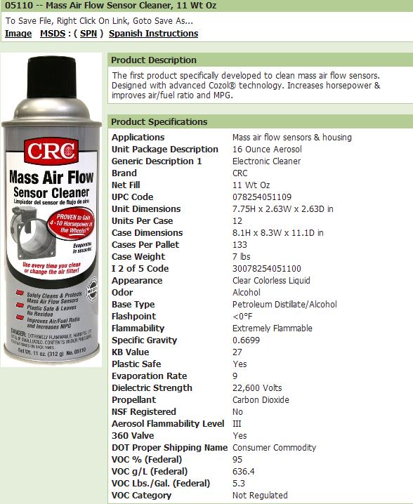

    I clean my MAF every time I clean my filter. I use QD Electronic Cleaner the CRC electrical parts cleaner made for wire connectors and the like. Then after that dries I spray the residue off with a can of the compressed air the keyboard cleaning stuff. The QD Electronic Cleaner is delicate enough for Karman-Vortex sensors. I used to work at an auto part store and this was the suggestion by our Senior Tech when I went up to him showing that I cant use MAF cleaner on my car.
    http://www.frontiernet.net/~jcray/04...C_QD_specs.JPG
    http://www.frontiernet.net/~jcray/04..._MAF_specs.JPG
    The QD electronic cleaner is very similar, but less concentrated I believe. The propellants are different as well.
